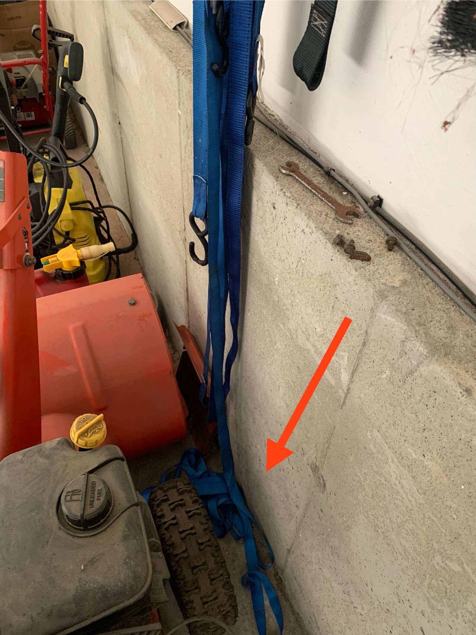

Twisties Posted Monday at 01:36 AM Share Posted Monday at 01:36 AM .... we used to have a trailering forum. Yeah, really. Every few years it would even get a new post. Now, no more. I'm not really sure where to put this post, so I guess it goes here. Yes, it's about trailering your BMW motorcycles. Basically, I want to know if anyone knows of a good primer available on line that covers the do's and don'ts, as well as hear your thoughts on what went wrong. Hopefully we all learn something. We've been trailering for years now, but have recently had two incidents. In the latest a brand new set of straps almost failed. They were rated 1000lbs working load, 3000 lbs break strength and were 1.5" wide with a good ratchet mechanism. They seemed like overkill. The bikes weigh about 600lbs and most of that weight is on the trailer floor. Our older straps were 1" and had built-in loops that we put around the forks above the triple tree. These new straps didn't have built-in loops, so we strung them around the forks above the triple tree and back to the cleat on the trailer. All seemed secure. We also placed a second set of older ratchet straps on over them, for extra security. The result, after 1600 miles, was as shown in the picture. Three straps were like new and one was about to fail. The tear was at/behind the fork/triple tree and could not be seen in a casual quick check. All straps were checked at each stop. I look and touch. All straps had proper tension. I'm fairly certain we did not over-tighten. After the incident I checked for sharp or rough edges and did not find anything. My analysis: This is the first time we've ever looped the straps all the way back to the trailer cleats on the floor. Every other time our straps had built-in loops, or we had used soft straps. Also, it is a wider strap than we've had before. I think it shouldn't have been looped like that and that we should have used our soft straps. I've done some searching and what I've found reinforces my understanding that soft straps are mainly to keep the hardware away from the bike to prevent scratches. But, I can't help but believe after this incident that stretching a wide strap around the curves of the fork and triple tree is a no no. It would seem to me that the outer side of the strap would experience more stress than the inner side. A soft strap is usually a bit narrower and built tougher. Our soft straps are rated over 10,000 lbs. In any event, I suspect these straps should be used in straight line applications and soft straps should be used at the forks. Link to comment
